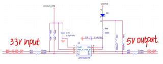

Dear Team,
Could you help to double check the schematic as below?
Many Thanks,
Jimmy
  • The 5 V pull-up resistors are extremely strong. Your 3.3 V device probably does not have enough drive strength for them. In general, I would use something like 3.3 kΩ. Does the 5 V bus have a very high capacitance?
    Otherwise, looks OK.
