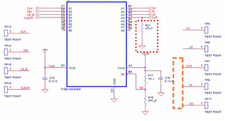

請教一個問題,
我們的板子上有使用到一顆
TITXB0108, level shifter,
目前正在生產中, 發生一個情況如下,
在開機時, 輸入腳PIN=A4/CLRlow,
但偶爾會發生對應的輸出PIN= D3/CLEAR信號會是 high,
此時如果將B4/CLEAR先強迫接地後放開, PIN= D3/CLEAR信號會是 low ,
接著都正常,
但發生這個情況時,
其它的腳位CLK/DIN/LE_B, 輸出和輸出的波形都是正常,
這個現象大約是20次開機, 會出現1
請問這個現象有辦法解決嗎?
電路的接法如下圖
請您再回信, 謝謝

  • You must not use such a pull-down resistor with the TXB; see section 8.3.5 of the datasheet. (And a weaker resistor would not be able to override the signal that the TXB outputs at A4.)
    For unidirectional signals, use a unidirectional level shifter like the TXU0104.
  • thank for reply,
    CLR from TXB010B pull low to GND, and CLR dont have signal on it.
    But output CLEAR go high when VCCA from 0 to 3.3V, so i set CLR by 47kohm on it, but it seem dont work,
    and I try to change 47kohm to 1kohm , and i add capacitor 0.1uF on OE pin to seperate VCCA and OE timing sequence,
    it can work properly, i will try it again by other PCB
    thanks
  • Put pull-downs on both CLR and CLEAR. And the value must be at least 50 kΩ.
  • thanks for reply,
    because when i do the test at output,
    i connect output pin of level shifter with 5V,  and i float at output pin,
    output pin may keep 5V after testing,  and the input  turn into high and output pin keep high,
    i think there is some spike at output, this situation let output pin have some false status
    but if i suddenly touched to 0V with wire at output, input and output comes to 0V,
    so  i change pull low resistor to 1kohm, the CLR/CLEAR keep low all the time,
    CLR is not use when the circuit  is working, so i change input pull low resistor to 1kohm,
    is it suitable?
  • With 1 kΩ, the TXB will not be able to drive the pin high. I do not know if this would be required in your circuit.

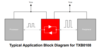

  • Hey Stone,
    The TXB's internal architecture is always actively driving the outputs, while also having the signal being driven back into the input side as well:
    Following through with Clemens' response, please see the Effects of pullup and pulldown resistors on TXS and TXB devices for more information.
