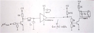

Dear members
In our digital signal conditioning application we use the hex inverting buffer CD4050BPW_SMD. What happens, is that if we apply simultaneously to the 6 outputs a consumption of 3.5mA, some devices are damaged. What is the maximum output current per gate? What is the maximum total current that the device can provide?
I appreciate any kind of help
Farzaneh
