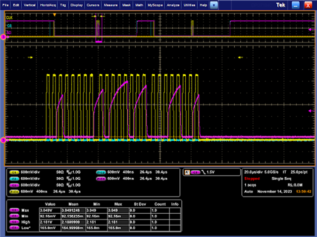

My customer use LSF0108 for SPI level transition. Customer report that the voltage on B side is 1.8V which is equal to VCCA. Could you pls review the schematic and advise? Thanks!

B2 was pulled up to 3.3V through a 2.2k resistor, but the voltage of this pin was abnormal. The waveform is as follows(Red). Is there any other suggestions? Thanks.

The line capacitance and the pull-up resistor form an R-C low-pass filter. To get faster edges, you need stronger (smaller) pull-up resistors.
The LSF's architecture is necessary for bidirectional translation. For unidirectional signals like SPI, a unidirectional translator like the TXU0304 would be a better choice.

When reducing the pull-up resistor of MISO to 330ohm, the waveform is improved, see the purple waveform in the figure below, but at this time the low voltage level reaches 600mV. Considering that the current through the pass transistor is only 9mA, this low level seems too high. Do you have any comments?
As can be seen from the picture, the rising edge of purple MISO is still slow when the pull-up resistor is 330ohm, but the clock signal CLK is not connected to an external pull-up resistor, but its waveform is good. Why is this?

The LSF is a passive switch. The low level depends on the drive strength of the other devices.
For voltages below VREF_A, the LSF works as an analog switch. So slow edges happen only when translating to a higher voltage.
The TXU0304 would not have these problems.
Hailiang
Because the clock and MISO signals go in opposite direction. The master actively drives the clock up to 3.3 V, so the output quickly reaches 1.8 V. But the slave drives the MISO signal only up to 1.8 V, so the remaining rising edge is driven weakly, only by the pull-up resistor.
