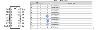

Customer looking to qualify TI vs On Semi , TI PN (SN74AHCT00PWR) in place of On Semi PN (MC74VHCT00ADTR2G),  but the TI data sheet  appears to have errors in pin function table as follows:
  1. Pin configuration of Pin 8 shows Output but in the Pin Function table it represents Input.
  2. Pin Configuration of Pin 9 shows Input but in the Pin Function table it represents Output.
  3. Pin Configuration of Pin 11 shows Output but in the Pin Function table it represents Input.
  4. Pin Configuration of Pin 12 shows Input but in the Pin Function table it represents Output. Please see the below attached snapshot from the data sheet.

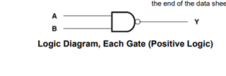

Inputs are suppose to be A, B and outputs are Y.
Does logic team have an updated data sheet that has correct pin function table?
The Q1 version part data sheet looks to have correct pin function table.
