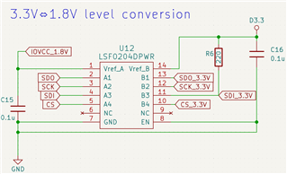

I am posting this because the Auto-direction voltage translators (LSF0204D) are not working properly.
Control the IC with 1.8V.

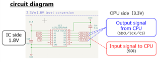

Inputs and outputs four signals from the CPU for SPI communication.
Convert the CPU signal (3.3V) and IC signal (1.8V) using LSF0204D.

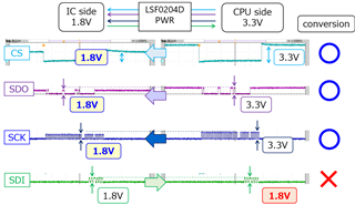

Three signals (SDO/SCK/CS) from the CPU can be converted from 3.3V to 1.8V.

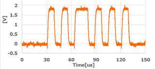

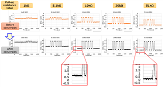

The signal (SDI) from the IC cannot be converted from 1.8V to 3.3V.
Please let me know if I am using it incorrectly.
