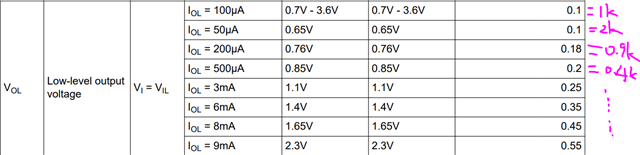

     4-2. VOL/IOL = Output low impedance but the value is inconsistent.(?)

    4. What do you men with "inconsistent"?
    I mean the value of VOL/IOL as below:
    Thank you.

    The gate-to-source voltage of the MOSFETs is the supply voltage, so a higher supply will result in a higher drive strength, i.e., a lower output impedance.
