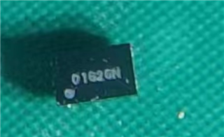

Hi'
Could you please help me confirm the marking of this product
The datasheet is 2GN, which is more information
Could you please help confirm the meaning of marking
thank you
  • Hi Yingjiao,
    The marking is a form of material identification for a specific Lot Trace Code i.e. it tells the Year (2020), Month (January), and the Assembly site information (62GN), thanks.
