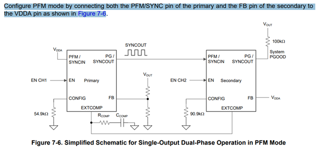

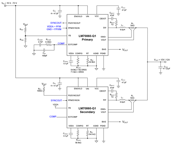

LM70860-Q1: I want to draw a circuit that uses two chips at the same time
Part Number: LM70860-Q1
Hello, I would like to ask you something.I read the data sheet and I don't know how to connect.I'm going to use two and output one to the same line as the main one as a sub.I'm trying to make a circuit diagram so that the input is 18V-32V and the output is 12V, but I don't have a reference circuit, so it's hard to understand. Is there a reference circuit that uses two at the same time to output 12V?
