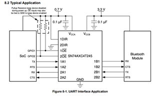

SN74AXC4T245: Two UARTs --- How to wire RX/TX for each?
Part Number: SN74AXC4T245
Hello.
I have an application where I have two UARTs.  I am not completely sure and would like confirmation on how to wire these.  I am using the reference
scea065b page 7 figure 2-7 which lists A1, A2, A3, A4 however this does not align with the actual product pins which are labeled 1A1, 2A1, 1A2, 2A2 on the datasheet....the same is true for the B side.
Can you please confirm the alignment of pins on figure 2-7 with the actual pins on the datasheet of above subject ?
