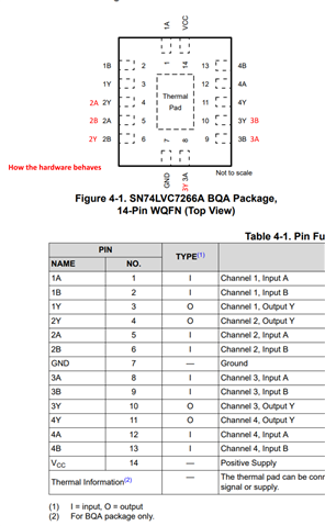

I have used the SN74LVC7266ABQAR on a design, but the behaviour does not seems to be in line with the datasheet.
Can you check if the datasheet is correct or not?
I have highlighted in red in the image below how it seems like the device is behaving based on my measurements.

  • Hi Rune,
    I just received the parts today. Please give me a week to prepare a board and test the part to see if the pinout matches the datasheet.
    Malcolm
  • Hi Malcolm,
    Thanks for checking this out and confirming my suspicion.
    BR,
    Rune
  • Hey Rune, Malcolm,
    Thanks for bringing this issue to our attention. We are looking into this further and will get back to you regarding the appropriate fix action from our end.
  • Hey Rune,
    Thanks for your patience on this issue.
    We have determined that the devices were shipped with the wrong pinout and we will be fixing the physical devices to match the datasheet. If you have ordered these devices from TI, expect to see a recall in the near future. If you ordered through a distributor, I'm not sure how the process works (because I've never seen this type of issue before), but I would expect them to reach out to you after the recall is posted.
    If you want to use the devices you have, that is fine (they will work correctly), however I would recommend any production build to hold off until we can correct the issue.
    In the meantime, we do have the SN74HCS7266 (and SN74HCS7266-Q1) that is the same function that may work for your application.
