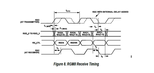

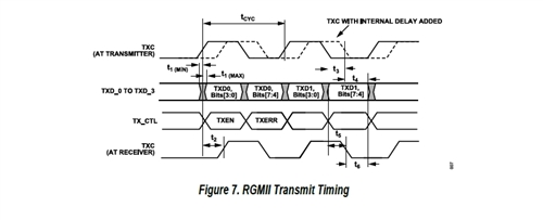

For below RGMII spec, does TXV0106 can support?
Va to Vb = 1.5V to 1.8V.
thanks!
Thanks!
thanks!
Thanks!
Hello Jeff,
Let me check with our team if RGMII signals can be supported at 1.5V. I'll respond back as soon as I can. Thank you!
Josh
Hello Jeff,
The team was able to confirm the TXV0106 can support RGMII signals when VCCA = 1.5V and VCCB = 1.8V. Thanks!
Josh
