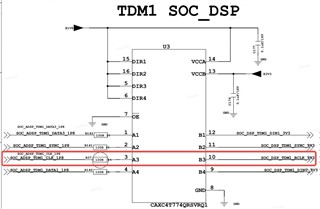

Hi team,
My customer is using this device as 1.8V to 3.3V level shifter for TDM signal. It is sensitive for the propagation delay time. The delay time will have impact on the sampling time.
Below is the schematic from customer. As checked in datasheet, the propagation delay time from A to B and B to A as below.
To make sure the accurate of the TDM data transfer, we would like to check with about the propagation delay time distribution data across high and low temperature(-40C to 125C) and device to device propagation delay matching data. Could you share that?
Thanks!
