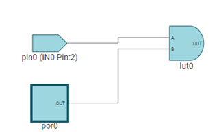

Could you let me know how it can make buffer?
I would like to make below circuit.
Thanks.

Hi David,

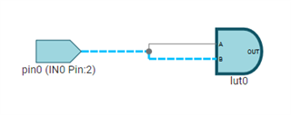

Buffers are not needed once internal to the device. Buffers are typically used to increase signal integrity and redrive a signal, but once you have passed an input pin a buffer would not be needed as the signal is being redriven inside the TPLD.
This would be the simplest way to make a buffer, or I've seen
From people who are paranoid the LUT will output before the device has fully powered on.
This is not an area of concern from our team as the device only begins operating once the POR sequence has completed regardless.
-Owen
