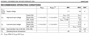

The datasheet does not tell me the Vih minimum from the B-side with 3.3V supply.

  • In the recommended operating conditions, VIH is specified as VCCI − 0.2 V. (For open-drain signals, the line is pulled to VCCI by the pull-up resistor.)
    If the reference design does not switch the VCCB supply to 1.8 V, then I do not understand how it would work. (The TXS works like an analog switch for voltages between 0 V and VIH.)

    The VIH thresholds is stated here:
    Note the I/O lines have different architecture (switch-based, similar to that mentioned by Clemens) where as the SEL/CLK line has buffering circuitry, hence the different threshold requirements.
    You may see this FAQ regarding the stringent thresholds for the I/O lines here: e2e.ti.com/.../faq-why-are-the-txs01xx-vih-vil-specifications-so-stringent

  • exactly, how I read it. So an SD card, which has "stepped down" to 1.8V and connected to the B-side (with 3.3V supply) should NOT work.
    I must contact TRENZ about their consideration about WHY it works. I will arrange for measurements of the actual signal levels.

    The problem has been solved. Interfacing an SD card needs pull-ups on the CMD and datalines. This is the reason, why the design which uses the TXS02612 works. The levetranslation from 3.3V to 3.3V is not needed, but the build-in pull-ups saves the design.
    I just added pull-up resistors to the design, and now it works.
