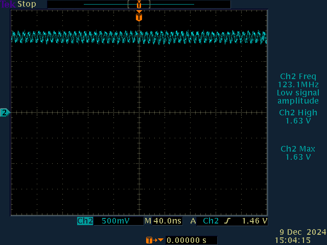

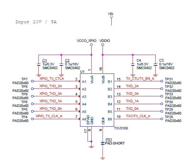

We created a small board to stack on top of the original daughter card to validate the TXV0106 (as shown in the image below). The circuit is straightforward, as below figure, we have use 4 TXV0106, I will pass full schematic via privacy message.
We are currently facing an issue:

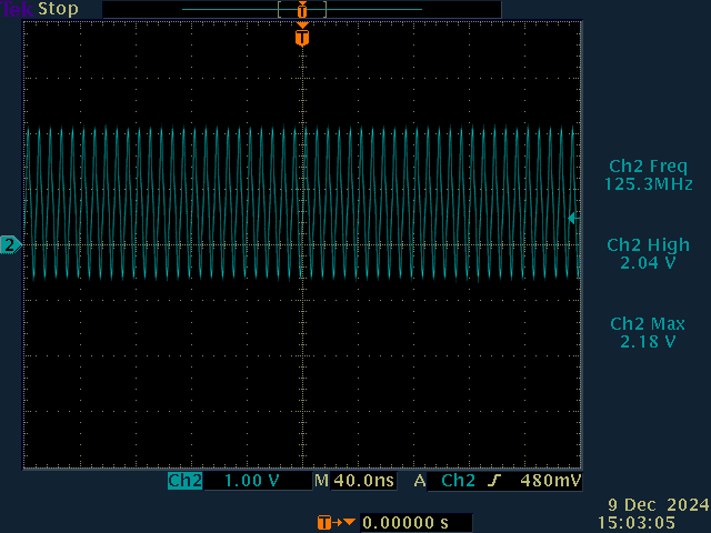

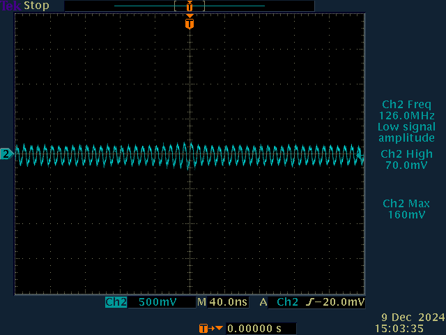

When the TXCLK on side A (input) of the TXV0106 is 125MHz, the TXCLK on side B (output) (refer to the attached TXCLK.BMP) is also 125MHz. However, the small board's GND (GND.BMP) and POWER ( VCCO_XPI.BMP) become abnormal, as shown in the attached files (VCC_XPIO.bmp and GND.bmp), which in turn affects all other signals (e.g., RXCLK_OUTPUT.BMP).

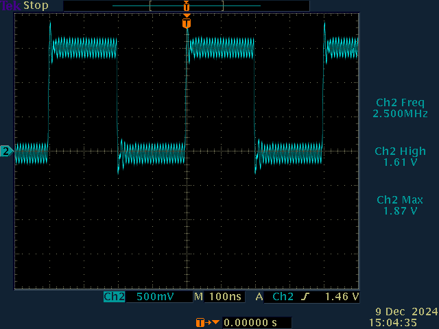

When the TXCLK is reduced to 2.5MHz, all signals return to normal (refer to RXCLK_Nor.BMP).
Or, if I disconnect the TXCLK output on side B of the small board (i.e., not connected to the PHY on the daughter card, but TXCLK still outputs), the issue does not occur.
1.VCC_XPIO
2. TXCLK
3. RXCLK_OUTPUT
4. RXCLK_Nor
5.GND
Do you have any suggestions on how to resolve this problem?

  • Switching at 125 MHz generates many current spikes on the supply lines. I'd guess you have to add decoupling capacitors to the small board.
    The ringing on the data lines might be a measurement artifact. For such high frequencies, you should use a ground spring instead of a ground clip for the oscilloscope probe; this requires adding nearby ground contacts to the small board.
  • Hi Clemens,
    On my original small board, each TXV0106 already has two 1uF MLCC capacitors on both the A side and B side power supplies. Today, I added an additional 10uF MLCC as an experiment, but the results remained the same. I also changed the measurement method to use a ground spring, but the outcome was still identical.
    Thanks!
    Jeff
  • How exactly are you measuring these voltages? What is the reference for the GND waveform?
    I suspect that the waveforms would look better when measured against the TXV's GND pin, and that these problems are caused by the small board's power rails not having a low-impedance connection to the rest of the circuit.
