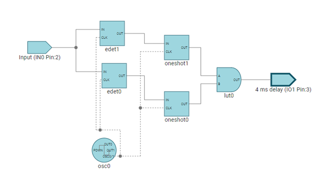

When using edge detection logic devices, I found that the pulse width output when the corresponding edge is detected is 230ns, which is a bit too long for my current design requirements. I want to know how to reduce the width of this pulse.
thanks!
    Just to clarify, are you using the TPLD1202 and is this the edge detector block? If so, the simulation tool is not exact on the length of the pulse width that is output by the edge detector. The real pulse width would be approximately 20 ns.

  • Hi,Ian Graham.
    Okay, I understand what you mean. As for the two questions mentioned above, I have one more question to add. Can the pulse triggered by edge detection only be 20ns? Can this value be modified? Can the function of clearing when the pulse width is lower than the delay time be turned off?
    thanks!
    The edge detection pulse from the edge detector block is always 20 ns. The delay block filtering out short signals can not be turned off. You can build a delay block using the logic and timing elements in the TPLD, as I've done below, but delaying a signal with this method still filters out pulses received while the first pulse is being delayed, shown in the simulation.
    Ian

  • Hi,Ian Graham
    It's okay, I have implemented a delay beyond the high level time of the input signal through your logic diagram. Thank you for your help.
    Thanks!
