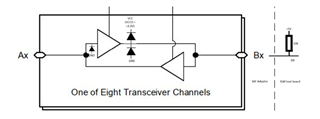

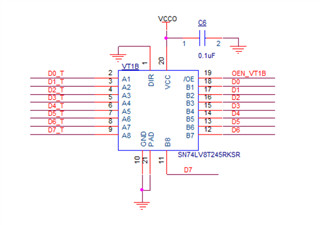

Hello. I have a question regarding the SN74LV8T245 octal bus transceiver. We are using this device to translate from +5V (B-side) to +3.3V (A-side) I/O. The circuit diagram is below:
This device is actually on an adaptor that sits on a host board. On the host board the D0~D7 lines are pulled up to +5V with 10K pull-up resistors. The setup is shown below (one channel):
The problem we are finding with this setup is that the VCCO (+3.3V) voltage rail is being pulled up to +4.2V. It appears that the combination of the pull-up resistor and the upper clamp diode of the A-side output buffer provide a path from the +5V rail to the +3.3V (VCCO) rail.
Please could you comment on this.

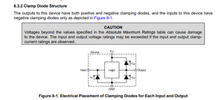

  • Hi Clemens, Thanks for your reply. You are right the SN74LV8T245 only has a pull down clamp diode at the input and pull-up and pull-down clamp diodes at the outputs:
    The marking on the device is:
    In my diagram above I have added them for the A buffer. The problem comes in that the A buffer is un-enabled (as DIR is GND (I need to check this) and I am translating from B to A) but the clamp diodes are still present. This gives the problem I have outlined above.
    As another experiment I have isolated the adaptor from the host board and powered it from +5V. I have then pulled D0 up to +5V with a 10K resistor and the +3.3V supply on the adaptor rises to +4.2V.

  • Hi Clemens, Ok, so I have measured the current flow through the 10K resistor, it is 13uA. So the voltage drop across the resistor is 0.13V. I have also measured the DIR input pin on the SN74LV8T245 and it is GND.

  • So the voltage drop over the diode is 0.67 V, which is plausible. And I guess that 13 µA also is plausible for all devices connected to VCCB. As you've suspected, this looks exactly like a diode.
    I'd guess that this is the output diode, and that it does not get disabled even when the output is disabled by DIR. Figure 8-1 might be technically correct, but is misleading for a transceiver where all pins are both inputs and outputs.
    As far as I know, a device with the Ioff feature would disable the output diodes.
