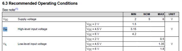

Hi team,
Can you advise? Vcc=3.3V condition.
We only see Vcc=2V; 4.5V and 6V.
See [FAQ] What are the performance specifications of the HCS logic family at 3.3V operation?
For output currents below the VOH test condition, the output resistance is constant; see [FAQ] What is the output voltage (VOH or VOL) when the output current is X or the supply voltage is Y?
