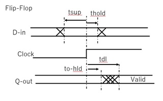

Q1. Can you provide me the timing information on the minimum set up (tsup)
and hold (thold)time of flip-flops relative to the clock.
Q2. Can you provide me the timing information on the minimum output hold (to-hld)
and output delay (tdl) time of flip-flops relative to the clock.
Q3. Can you provide me the timing information on the minimum set up (tsup)
and hold (thold)time of delay/counter relative to the clock.
Q4. Can you provide me the timing information on the minimum output hold (to-hld)
and output delay (tdl) time of delay/conters relative to the clock.

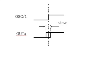

Q5 Can you provide me the maximum skew between OSCx outputs.

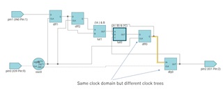

The reason why I came up these questions is that I concern the timing error of my design as attached.
This circuit is a simple example of detecting the edge of an input and make arbitrary delayed one-shot pulse.
The Flip-Flops and delay modules are the same clock domain but on the different clock trees.
If tow clock trees have substantial skew, there is a risk of timing violation resulting unpredictable error.
This kind of error may occur by chance and hard to identify.
So, I want to eliminate such risk in design phase.
