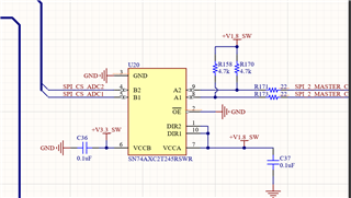

SN74AXC2T245: Pullup on SPI CS signal
Part Number: SN74AXC2T245
Dear
We use SN74AXC2T245 to translate CS SPI signal from 1,8 V rail to 3,3 v Slave device, according to data sheet there are internal pulldown of 74 ko inside IC on I/O lines so in case of Pullup is needed it is reco to put low value less than 7 ko, we did it on the 1,8 volts parts, but wat about the left side B1 and B2 line, should we need to put pullup here also ?
