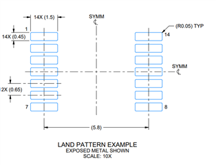

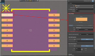

Hi Teams
According to the specification, the length and width of the Footprint pad are set to 1.5mm * 0.45mm (as shown below)
However, the pad downloaded from the official website is 1.41mm * 0.356mm (as shown below), which is quite different from what is specified in the specification.
So I would like to ask you to help confirm
1. What is the minimum length*width setting of the pad?
2. Will there be any problems when we ship the items?
