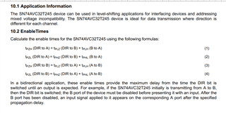

My customer has the following question:
- Do we need extra control of OE pins before reverse direction or only direction pin change is needed?
- How to evaluate the direction turnaround needed waiting times?
