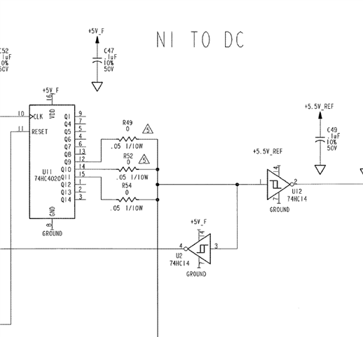

The clamp diode characteristics. During the power up transistion, the Clamp diode drop is more and hence pulling VCC to higher voltage level. This causes a failure in the unit level. The existing design was using a similar part from ONsemi MC74HC14AD,which doesnt causes this failure. The TI CD74HC14 was considered as FFF equivalent and went ahead with same design.
Kindly advise.
