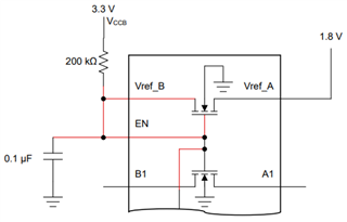

Hi team,
Recently we are using LSF0108 with our on-board xds110(3V3) to get a 5V SWD port.
XDS_VCC = 3.3V, XDS_VBUS = 5V
However in some cases the SWD comms will fail
  1. example 1 - SWD is fine when using jumper to connect on-board MCU
  2. example 2 - SWD fails when using the dupont Line to connect external MCU
  3. example 3 - SWD also fails when using the dupont Line instead of jumper to connect on-board MCU
Is there any concern when using LSF device as SWD level shifting?
