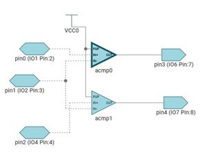

I am trying to replicate the first example, just the two analog comparator but only the first seems to work as expected.
If I use the original example it works perfectly. If I start from empty it does not work.
here is the saved file content from demo that works fine followed by the abnormal one:

Any suggestions?

  • Hi Luca,
    Are you referring to issues when programming a device, or simulating?
    I don't see any simulation options specified in the file you uploaded, so that would need to be added in order to see correct outputs from the ACMP.
    See 5.1.3 Setting Simulation Inputs
    If you are having issues with programming the device could you be more specific. Is it after the device is programmed? Do you have waveforms? etc.
    Owen
  • Hi Owen,
    sorry, I will try to explain better. With both versions of my uploaded files, when I press the button "configuration" the system programs in ram the 1201, then the 1201 start to work. Whit the second file, moving the R1 (IO1) I can see the LED (IO6) turn on/off, but moving R4 (IO4) the LED (IO7) remains off. With the first file instead all works fine. So Where is the difference? May be some programming errors in ACMP1 configuration? I do not understand. If the graphics are the same, why the files are different? Please try yourself to replicate the above situation.
    Best Regards
    Luca
  • Hi Luca,
    The issue is because an Oscillator is not in your design.
    In version 1.3.1 our teams tried to introduce a power saving feature that turns the oscillators off if they are not included in a design. We have seen a negative impact of this on other features of the device not related. It turns out the ACMP is gated by the oscillator at startup, so it needs to be left open to allow the ACMP to work.
    This is done to prevent weird output glitching while the device is in startup.
    Simply add an oscillator to the design. It can be left unattached and in auto power on mode to save as much power as possible.
    Owen
