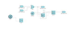

Hi,Malcolm Lym
I want to try using the PULSE WIDTH MODULATOR device to complete this idea, because I see the existence of CNT devices. Can we use a 25MHz CLK to obtain the count of (A-B) duty cycle times (DATA), and then use the PULSE WIDTH MODULATOR device with a clock of 12.5MHz CLK to output a PWM of 2 * (A-B) duty cycle. May I ask if this is feasible?
Thanks!
Hi m l,

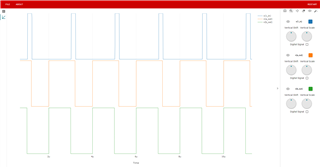

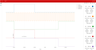

Yes, this is feasible. I have tried another design which can get close to 2x duty cycle. It depends on what level of precision you need. In my design, I count up on the counter when the (A-B) pulse is high, and then down to double the pulse. I have attached my design to this message, you can see a screenshot of my simulation result. Red signal is A-B, Purple is 2(A-B).
Right now I am using ~50kHz clock for the counter, you need to pick the clock carefully depending on frequency of A/B. It needs to have less than 255 cycles for the high pulse duration of (A-B), the faster the clock to the counter, the more precision you get on the output pulse.
Red pulse width is 200us, purple pulse width is 430us.
