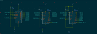

Hi TI Team,
I am Using Swift Resistor with ESP32
Can you check the circuit as per our standard.
3 Swift Resistor is connected as Cascade
Can you help me with Firmware or resistor logic
1. I want one by one go High ESp32 set to high as per Condition.
  • Hi Saurav,
    For some information on cascading our shift registers, see this app note: Designing with Shift Registers
    Your output enable pin for the middle shift register (U13) is left floating, which means the outputs might not behave as expected.
    Also, from what I can tell, you might be cascading backwards: I assume the order of data is supposed to be U14 -> U12 -> U13, instead of U14 -> U13 -> U12 like you currently have.
