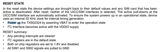

Hey,
I'm using the TCA9803 to buffer the I2C signal from baseband to the TXS02324.
The software department requests the HW-ID and gets a plausible answer.
However, after receiving this response, communication with the TXS02324 is no longer possible.
The HW-ID can only be queried again after a power reset.
Thanks in advance.
Markus
