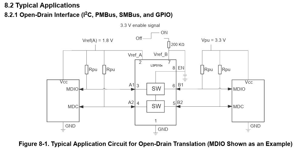

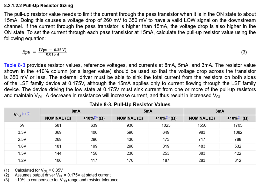

Based on the example below, the pull-up resistors on both sides of the LSF0102 should be the same, right?
If they are required to be the same, what would be the impact if different resistor values are used on both sides?
