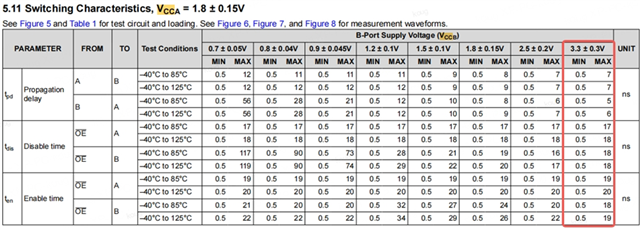

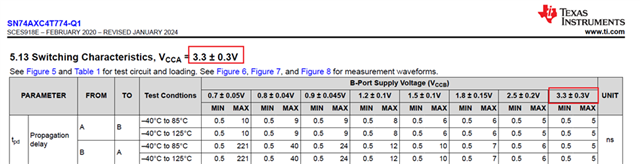

About Propagation delay, I have 2 questions:
  1. For different ports, are their Propagation delay same?
  2. The delay range between MIN and MAX is large, which will influence the signal quality in some extreme application conditions. For example, if using this to transfer SPI, if CLK, MISO and MOSI delay time is too different, will cause CLK edge data sampling errors. Do you have any corresponding files on this issue?
