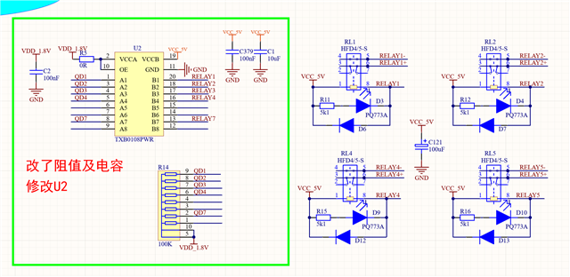

Dear teams,
I used TXB0108 drive relay,the circuit diagram is as follows.
I cannot drive the relay in actual use, and I feel that the driving ability is insufficient.
I was able to drive relays with LSF0108 before. Could you please help me see what the reason is?
