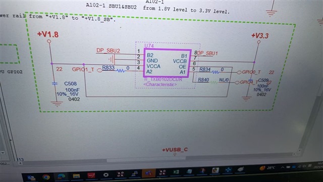

TXB0102: Help to review the sch and check the input side pin status
Part Number: TXB0102
Hi team,
Could you please help to review the sch:
My question is: When measuring A1 and A2 with multimeter after power on VCCA and VCCB w/o input signal, the multimeter shows 0, which means that this pin is high impedance? Does that make sense?
