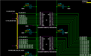

my schematic is as follows:

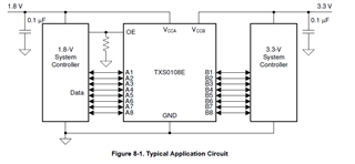

I believe my schematic is identical to the diagram below from the datasheet

  • The schematic is incomplete; it does not show anything connected to the TXS.

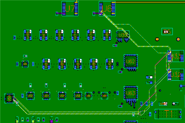

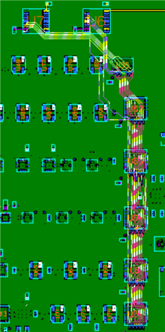

  • pdfjoiner (4).pdf
    I attach the schematic, the first page shows the TSX0108E devices connected to fpga bank 2 and the other sheets show the two busses, CH_SELECT(2:0) and FILTER_SELECT(9:0) connected to the d.c. digital select inputs of an RF switch and/or filters as illustrated above in the layout diagrams
