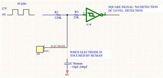

Hello, I am Sebastián Meneses, the reason for the inquiry is that we are using this trigger (part number CD40106BPWR) for a simple capacitive detection, but I have found differences in behavior in various integrated circuits (of the same part number) being the pcb the same. What we have noticed is that the mark is not entirely the same. I am attaching images
As you can see both images are marked with CM0106B on the first line.
the other 2 lines whare(ie 15k G4, ACY0) are for?
In some cases, we have found huge differences in capacitive detection due to differences in integrated circuits.
Could this be due to variability in the trigger's input capacitance from datasheet 5 pF typ, 7pF Max?
Thank you in advance,
