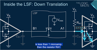

I had gone through LSF0204 Translator working
Below points are not very clear to me and I would require a detailed explanation on this
1. How RA1 is not required if the sink current is lesser than 1uA
2. what is the voltage level of A1 at the time and how
I have one more query

  • Hello Rohini,
    1.) The >1uA is a good quantifiable value for small leakage, at which the voltage at A-side will be clamped at VREFA, due to the specific biasing of VREFB shorted to EN. Section 3 of this app note: https://www.ti.com/lit/an/scea144/scea144.pdf?ts=1745613056245 provides example if excessive leakage were to occur and what behavior we can expect at the A-side outputs.
    2.) Yes, you may see section 9.2.3 of the LSF0108 datasheet where single supply translation is used. This way the leakage current flows through pulldown to GND instead of sinking into an LDO at VREFA side.
