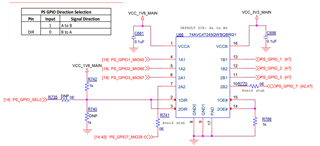

I am using the 74AVC4T245QWBQBRQ1 part on my board.
I am sending a continuous high pulse to the level translator, and when I probe the signal, I am getting <1V instead of 1.8V (VCCA = 1.8V).
When I demount the level translator, I am getting 1.8V on probing that signal.
The driver is a CMOS with a 1.8V IO level.
I have made the signal direction of all the 4-pins as A to B. Is this correct?
Below is the schematic. Can you please verify this schematic? Also requesting some debug suggestions.
  • Hello Sam,
    The schematic looks correct. When translating from A  to B, the translator inputs become high impedance. Meaning incoming signals shouldn't be impacted.
    Can we capture the voltage at DIR1 and DIR2 pins? Are you able to see any output signals?
