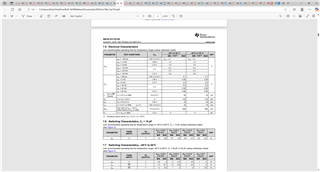

I have inherited an existing design where the SN74LVC1G125 is powered by 2.5V, and Voltage high output sources up to 500uA.  One critical requirement is Voh must be very close to Vcc.
In the data sheet  (Page 6) Table 7.5 Electrical Characteristics Voh at Ioh 100uA is Vcc-0.1V.  I assume that this specification is for adequate statistical coverage.  Do you have a histogram that
shows the actual distribution?
Since my load is 500uA could this be repeated for this source current value?
