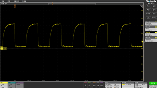

I have a problem with I2S connection. Please help me.

The LSF is a passive switch; the device that is driving the line must be able to sink the current through both pull-up resistors. When the current is too high, the VOL of your device increases (as you have seen).
When you have a push/pull output, then you do not need a pull-up at the LSF input pin.
The LSF has open-drain outputs, so you always need pull-ups at the outputs. The minimum pull-up value is determined by the drive strength of your device (here, the AP). The maximum pull-up value is determined by the capacitance of the signal line, i.e., by its length; if the resistors is too weak, the rising edges are too slow. For very long lines or when you have cables/connectors, it might not be possible to find a resistor that conforms to both limits.
Unidirectional, buffered translators like the TXU0104-Q1/TXU0204-Q1/TXU0304-Q1 would be much more robust. You would need a bidirectional translator like the LSF0102-Q1 only for the I²C signals.
I do not know what "clock fault" actually means; it might be possible that you're using a wrong frequency.

Our board is cpu(exynos) + lsf0108(level shifter) + tas6424-q1(audio amp)
Currently, the audio amp is generating a "clock fault" interrupt. So I'm currently contacting Ti export.
Please help me. I want to know what is causing clock fault (Reg 0x11) in tas6424 amp.

I will forward this to the hw team and ask if Clemens Ladisch's suggestion is applicable to our board. I am glad that this issue is not a software issue. Our hw said it is a software team issue.
Thank you. The hw team is not accepting the fact that the level shifter needs to be changed. Although it is difficult, I have conveyed the opinion of the Ti experts.
The hw team is reporting the fault interrupt (clock fault) of tas6424 as a problem caused by the register setting in the sw.
I will ask again if there are any other changes.
