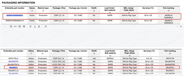

Is there any difference between part number JM38510/00803BCA and part number SNJ5407J? Is it the same product?

Hi Cassie,
The two parts that you listed in the question have the same exact datasheet, so as per my knowledge there is no difference between the two.

Dear Sudharsh,
After communication and understanding, these two parts products are the same. Could you help me understand why they have different names?
Cassie Liu
Dear Cassie,
The products have different names because they come in different carrier types. Hope this answers your question.
Sudharsh
And could you please tell me if these two part numbers can be taken the place of by each other? This question is very important to me.
Cassie Liu
Hi Cassie,
Based on the datasheet, there are no specific differences between the two parts that you may have overlooked.
Sudharsh
