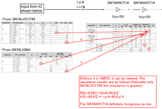

SN74AHCT14: interface level
Part Number: SN74AHCT14
Is the way of thinking correct?
