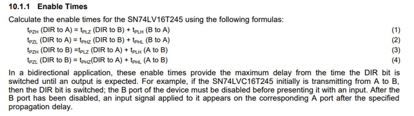

I would like to confirm about ''10.1.1'' .The usage conditions are Vcca=3.3 V, Vccb=5 V.
It is defined as below, but where are the propagation delays (DIR to A) and (DIR to B) defined?

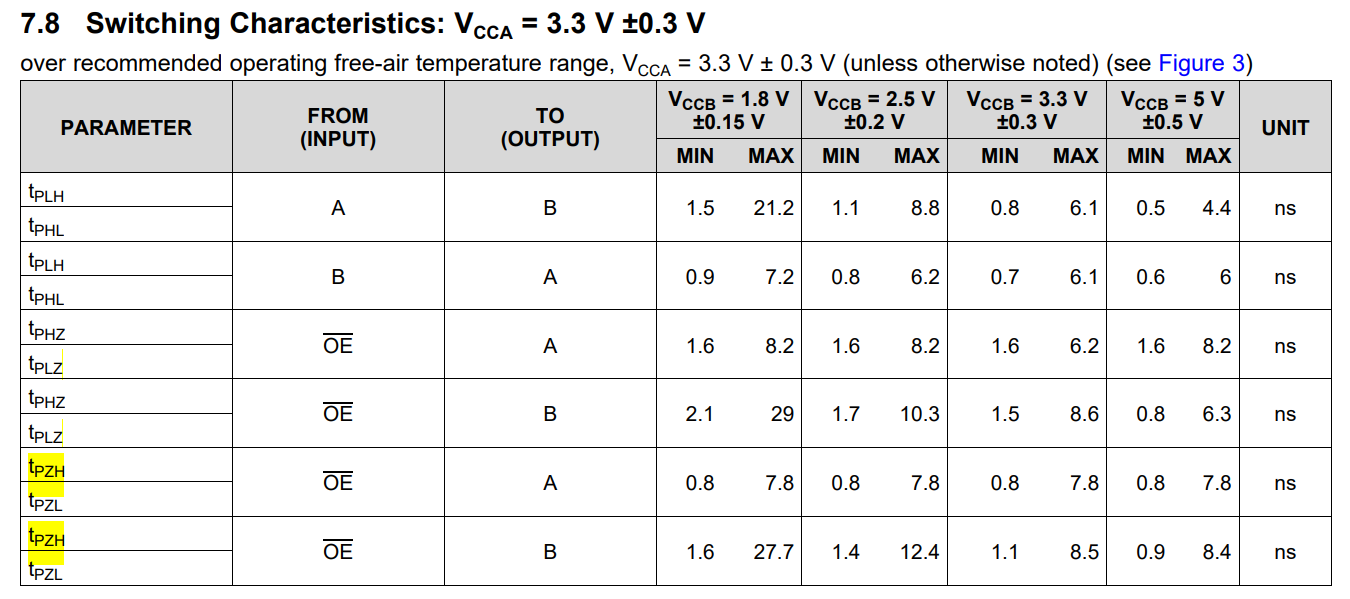

For example, if I want to know tPZH (DIR to A), can I refer to the time below?
Ryusuke

  • Hi Joshua and Clemens,
    Thank you for your reply.
    I understand that (DIR to *) should refer to nOE of FROM INPUT.
    If the above is correct, Should I refer to the left side or the right side of the equation below?
    I think the contents of the equation do not match the parameter of 7.8 Switching Characteristics: VCCA = 3.3 V ±0.3 V.
    Ryusuke
  • The test conditions are different. For section 7.8, see figure 3. The equations in section 10.1.1 are for a different case, when the signal that goes in the other direction also has a different value. For example, if the direction originally is A to B, and the input and output pins are both low, and the direction is switched, then you first have to wait for pin B to be deactivated, and then for the low B signal to be propagated to A. This case does not actually happen in practice because you would not want to have two devices driving the line at the same time.
