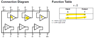

 DM74ALS14N symbol and function table below

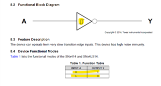

SN74AHCT14N,symbol and function table below

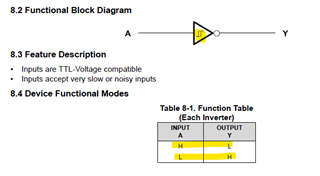

SN74LS14N symbol and function table below

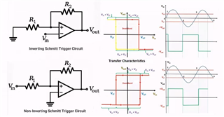

1. There is a difference in the symbol, and the symbol indicates whether the IC is an inverting or non-inverting Schmitt trigger, correct?
2. As per my understanding, the DM74ALS14N is an inverting Schmitt trigger, while the Texas part is a non-inverting Schmitt trigger, right?
3. According to the datasheet table, both perform inverting functions, but the symbols are different(DM74ALS14N is having inverting Schmitt trigger and Texas part are having non-inverting Schmitt trigger symbol). Can we consider the Texas part as a replacement?

  • 1. The Fairchild symbol shows falling edges, which indicate an inverting buffer. But the bubble at the output also indicates inversion, so it is not clear whether there are one or two inversions.
    2. All parts are inverting buffers with Schmitt-trigger inputs.
    3. The TI parts can replace the DM74ALS14N. Some electrical characteristics might be different.
  • Hi Clemens,
    Thanks for the clarification. There is no difference in the bubbles usage between Fairchild and TI parts. my doubt is the TI part show the non inverting symbol right, Then it needs to do only Schmitt-trigger function and no need to happens inversion right?. below is the reference.
  • TI shows the bubble for inversion, and the part does inversion. The function table is correct.
