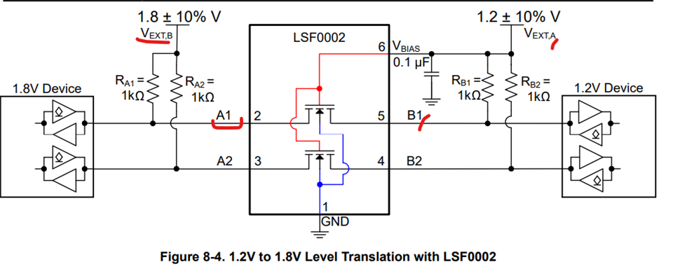

Hi, reading through the datasheet for the 1.8V to 1.2V bidirectional application, it's a bit confusing which side is A and which side is B for the reference voltage usage .
Are pins labeled A1/A2 the VEXT.A side, and B1 /B2 the VEXT. B side or is the side determined by where the VBIAS is connected?
Per Table 8.2 VEXT.A is supposed to be lower than VEXT.B and connected to VBIAS.
In 8.2.1.2.1 it states that "For the bidirectional translation configuration (higher voltage to lower voltage or lower voltage to higher voltage), the VBIAS input must be connected to VEXT,A."
But then Figure 8-1 below  VEXT,A is connected to the B side and VBIAS. But then shouldn't side A be the lower voltage signal in this case?
