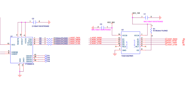

Hello All, My doubt is whether we need to pull the signal to VCC? Or this is OK?

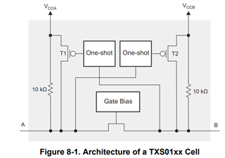

Hello Sankara,
Please see TXS architecture below.
Josh
