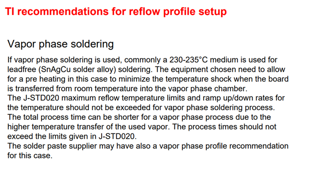

#1. Our reflow oven uses VPS reflow (vapor phase soldering). Is it possible to implement using VPS reflow?
#2. Could you please provide us with the reflow implementation conditions (temperature/time)?

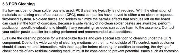

#3. Regarding cleaning conditions, we will conduct immersion cleaning in a cleaning tank using a semi-aqueous cleaning solution set at a liquid temperature of 80°C.
      Are there any issues with the semi-aqueous cleaning solution/liquid temperature of 80°C/immersion cleaning?

#6. There may be cases where hand washing with a brush is necessary. Is it possible to clean with toluene and ethanol?
