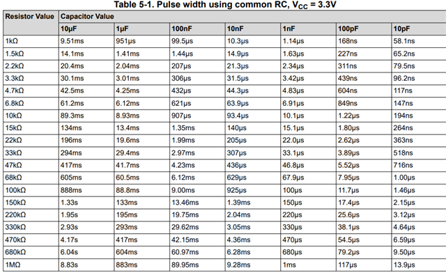

I am needing a monostable multivibrator that can operate from 15VDC supply, that can activate from leading edge or trailing edge, and can go down to the 1 us pulse width range.  Ideally looking for 1 - 100 us that I can dial in with a pot, in DIP config so I can use it on a bread board.  Do you know if TI has this?
