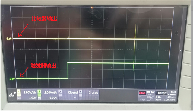

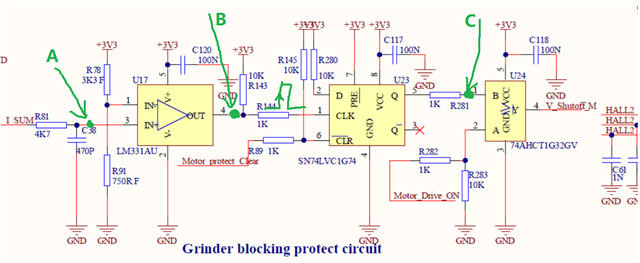

The customer found frequent unintentional trigger of SN74LVC1G74.
The customer  have tested the waveform.
It seems there is no any CLK input, but the output still toggled.
Could you help to comment on this?
Yellow: CLK input(Comparator Output)
Green: 1G74 output
