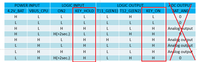

hi sir
if TPLD801 can do the function as the table?
thanks

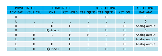

hi sir
thanks
Hi Chen,
It looks like this would require the TPLD1201, which has 8 GPIOs. The TPLD801 has only 6 GPIOs, and this table has 7 IOs total (4 inputs, 3 outputs).
Ian
