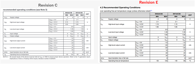

Hi all,
When Revision C→D (the latest is E) was changed,
I think that the 4.2 recommended operating condition in 4. Specifications, which is not described in the changes, has changed. (See below)
Which numerical value is correct?
High level input voltage Vcc=4.5 V Minimum value 3.15 to 1.15
Vcc=5.5 V Minimum value 3.85 to 1.85
We would appreciate your comments.
